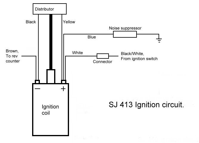

So have you got the 1.3 coil? If so don't run the ballast resistor.
The 1.0 and 1.3 coils have different resistances so must be used with the correct dizzy.
I presume the 1.3 you fitted has the electronic dizzy so no points?

Im going to sound stupid but how do i tell the difference between electronic and not?
Yes i have fitted the 1.3 coil that came with the engine.
Sorry i feel as if i should know that.

Re: Distributor problem
It should be connected like so --
If you unclip the distributor cap it should look like this--- Attachments
- dizzy.jpg (37.12 KiB) Viewed 6650 times

Cheers darrell thats a big help, yes my dizzy looks like that
Going to get on it in the morning cheers guys.

As darrell says
Buuuuttt as yours was a 410 there could be a brown wire in the loom that used to be part of the ballast resistor wiring and not for the rev counter (if you have one?) so just leave that disconnected at both ends.
