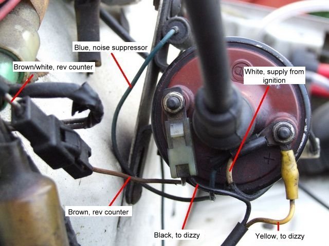

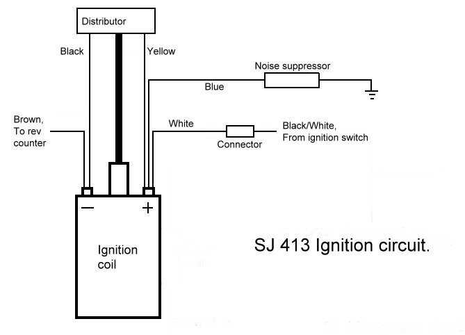

This do ya -
413 Coil Wiring.jpg (60.64 KiB) Viewed 31174 times
413 Ignition circuit.jpg (20.18 KiB) Viewed 31174 times

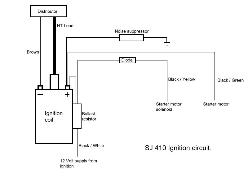

Re: does anyone have a wiring diagram for the ignition coil?
Post by Darrell » Fri Sep 14, 2012 8:05 pm
The 410 coil has a ballast resistor fixed to the side. This limits the voltage to the coil to about 9v I believe. This ballast resistor is by-passed under starting only. If it was fed 12v all the time I would expect it to overheat.
Any more info about the kit you have brought.
Diagram as shown in workshop manual (I haven't seen one with my own eyes :D )
I would assume that it would have either black/yellow to solenoid or black/green to starter. Not both as they both do the same job of supplying 12v on start-up.
410 Ignition circuit.jpg (24.46 KiB) Viewed 31155 times

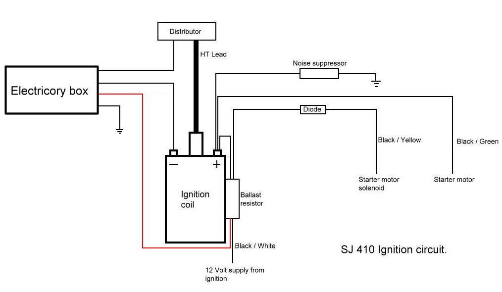

Post by Darrell » Fri Sep 14, 2012 9:18 pm
Had a look on fleabay and it says the 4 wires are power,earth,coil & contact breaker, so it's like this ??
410 ignition with electricory.jpg (45.18 KiB) Viewed 31142 times

Post by Jay18 » Fri Sep 14, 2012 11:12 pm
thanks mate! thats saved me alot of thinking lol will get that done soon also have to change the points as ive got a new set so need to get myself a timing light..
