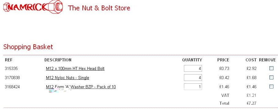

the rears are done now but i havnt been able to find a replacement bolt, started on the front now and looks like the same thing, problem is i cant get to a nut and bolt shop during the day because im working so could anyone tell me where i could order some from or if anyones got some spares for me.

I got my bolts from these guys. Don't forget some nyloc nuts and washers.
M12 100mm zinc plated bolts 8.8
http://www.namrick.co.uk/acatalog/Home_ ... 12_25.html" onclick="window.open(this.href);return false;
