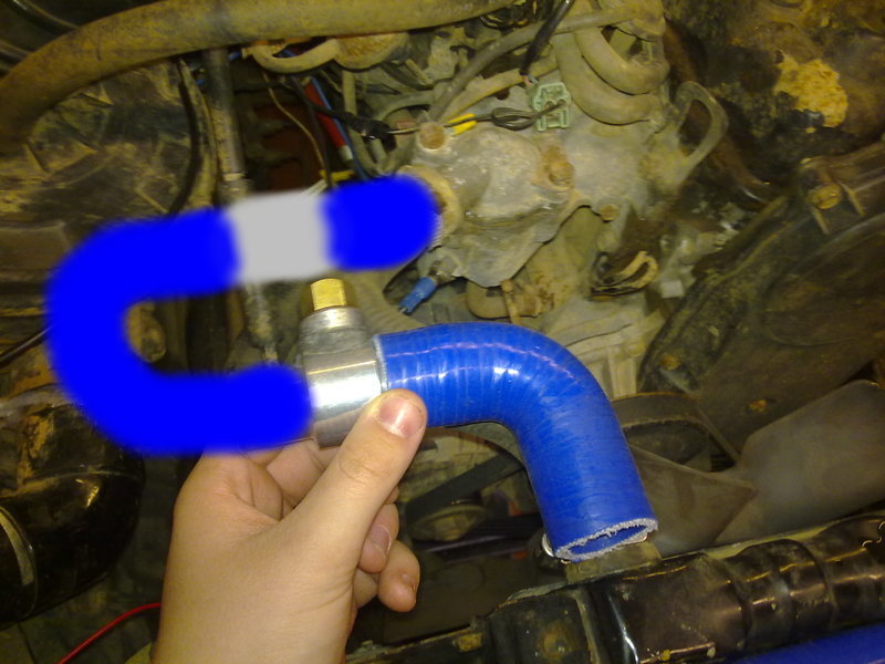

seam to hit a stone wall , my tim temp guage takes up pretty much most of the pipework in the top hoes all bends etc, so were else can i put the fan switch thing :argh:

Any pics of what set-up you have already.
Re: electric fans
Post by turbo-tom » Wed May 02, 2012 7:36 pm
this is what i have atm so far , the plan was then to get some a suitable bend and connect up but it seams i dont have enough room :( to get both adaptors in...
Re: electric fans
Post by Darrell » Wed May 02, 2012 7:59 pm
Looks a nice chunky lump. What thread does it have already, looks quite large. Maybe you could use that thread for the radiator switch and drill and tap a thread on the other side for the temp sensor.
A suitable suzuki swift radiator switch is 16mm x 1.5mm pitch (fine) thread. Most temperature sensors have a 1/8npt thread.

Post by Edweird » Wed May 02, 2012 8:20 pm
Could you not just have a big loop of hose?

Post by turbo-tom » Wed May 02, 2012 10:33 pm
Darrell wrote:Looks a nice chunky lump. What thread does it have already, looks quite large. Maybe you could use that thread for the radiator switch and drill and tap a thread on the other side for the temp sensor.
i could probably but my uncle made that sendor housing for me and he said that thread he cut in the tube was a very odd size special one or something :er:
Edweird wrote:Could you not just have a big loop of hose?
thats what im thinking now :lol:

Post by Darrell » Wed May 02, 2012 10:57 pm
:thumbup: Would work.
http://www.amazon.co.uk/Black-Silicone- ... 58&sr=1-40
Don't know what bore size is needed ?
Could use a slight bend from your old hose to join new switch to thermostat cover/housing.

Post by turbo-tom » Wed May 02, 2012 11:16 pm
Darrell wrote::thumbup: Would work.
cheers darrel n edd :D , i shall do that then , its going to be fawwking tight though :lol:
