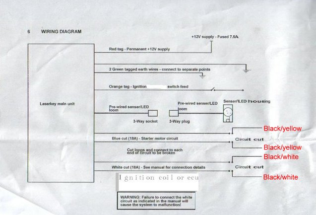

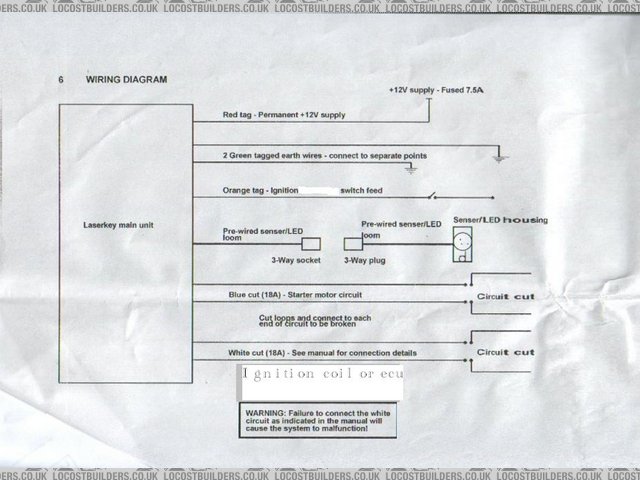

Received the toad system today. Any ideas on wiring it in as there are no instructions
There's a control unit, two touch sensors for your keys, receiver for the dash with led which wires into a plug on the side of the CU
But how do I know where the bunch of wires goes from the CU?

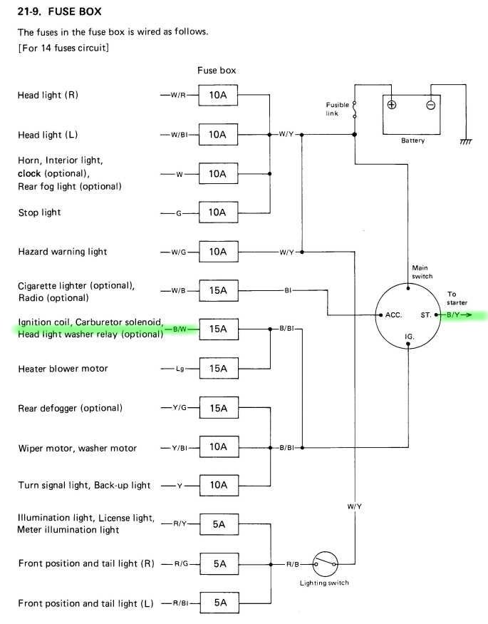

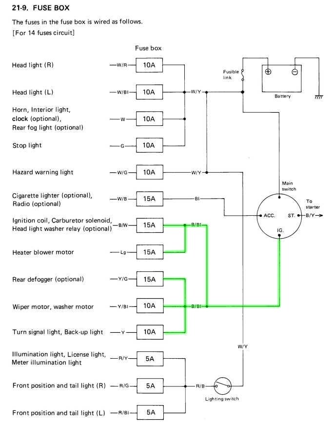

Post by Darrell » Sat Feb 04, 2012 4:40 pm
I've just had a read that the switched live needs to be live whist cranking so don't connect it to the radio supply wire.
Anywhere on the green highlight will do.

With the control circuit wires that are taped together, do I just cut either the wire feed to the coil or signal to the starter and wire these two wires in so the current basically flows through the CU before the component?
The power and ignition wires I can just splice into the circuits I choose out of your diagram?
Re: immobiliser systems
Post by Darrell » Sat Feb 04, 2012 8:15 pm
Christoff wrote:Ha ha thanks darrell.
With the control circuit wires that are taped together, do I just cut either the wire feed to the coil or signal to the starter and wire these two wires in so the current basically flows through the CU before the component? Yes, just break into the circuit where ever is convenient

Post by Darrell » Sat Feb 04, 2012 8:25 pm
The permanent live can come straight off the battery (via a fuse). If anybody cuts this wire it will not run as the relays inside the control unit could not be energised.
