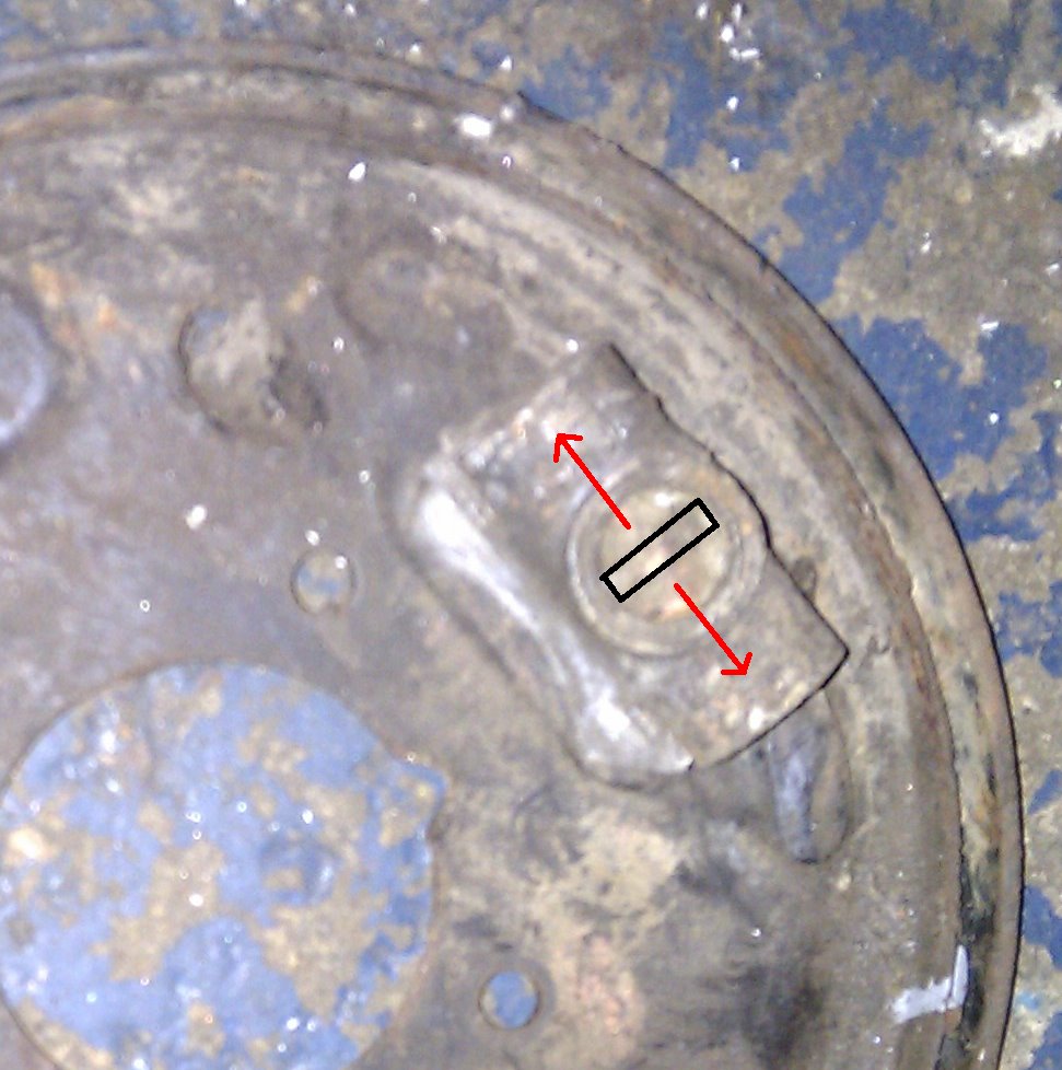

Post by st3f4n » Tue Nov 22, 2011 7:12 pm
ScottieJ wrote:
I haven't got this middle nut either, I grabbed a couple of pics whilst i was under the car so il try and upload them in a bit... Looks like getting the nut off is the only way. Any idea on sizes??
Ta

I wonder if someone has put the wrong outer drum on it then so you haven't got the access hole? Do you want me to measure where it is so you can drill one?

Post by st3f4n » Tue Nov 22, 2011 7:41 pm
Do you think any metal shaving falling in the drum could be a problem? If not then that would be fantastic and much appreciated...
I was also thinking a wrong drum had been fitted, The T-box is shiney as-tho its been taken off and cleaned/ a new one fitted
