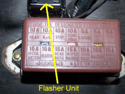

hi ppl i got sj 413 an its doin my head in :argh: .all indicators come on but dont flash nor does the hazards can any one help thanks
Re: hazards an indicators
Post by Darrell » Thu Oct 27, 2011 10:11 pm
:welcome: to the club.
Sounds like the flasher relay unit is knackered, assuming all the bulbs are standard (not LED) and working. However I have heard that the relay base can loose it's earth and stop them flashing (mostly spanish built one's). Pic is my Jap 413. Best make sure it has a good earth first.

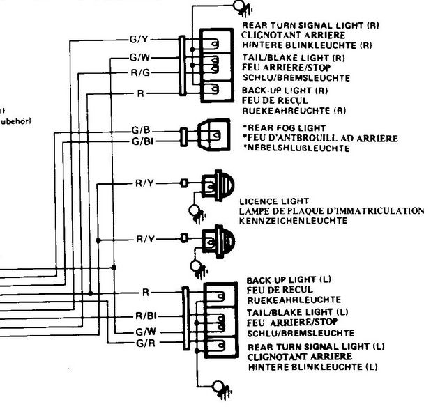

There's a black box connected in with the wiring for the rear lights that says flasher on it. Is that for the left and right indicators or something else? I.e can I remove it ?

No cos there's another section of wires for the trailer lights. This must be something else. The wiring diagram in Haynes doesn't help much tbh.

Only pic I have at min. Il get some more and add it to my thread sorry for the hijack.
Post by Darrell » Fri Oct 28, 2011 11:16 pm
Haynes manuals are normally very good but the sj-vitara one is shite and often referred to as the book of lies :D
As regards that unit, no idea, so, "if in doubt, chuck it out."

Darrell thanks for the diagram that looks more like the set up I have. I'm going to have a close look at what I have and try and draw my own diagram from what's there to compare.
