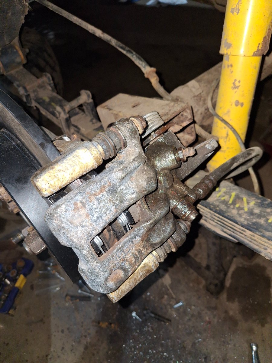

So I've started my rear disc swap.

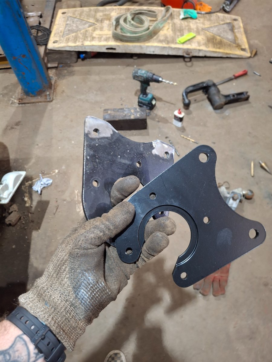

I bought a ebay disc conversion kit that just came with the caliper mount and backing plate for disc. I had the rear calipers of my old primera and thought I'd try make them fit instead so I would have a working handbrake.

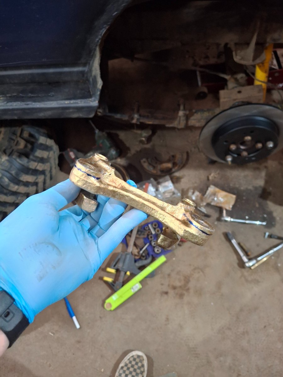

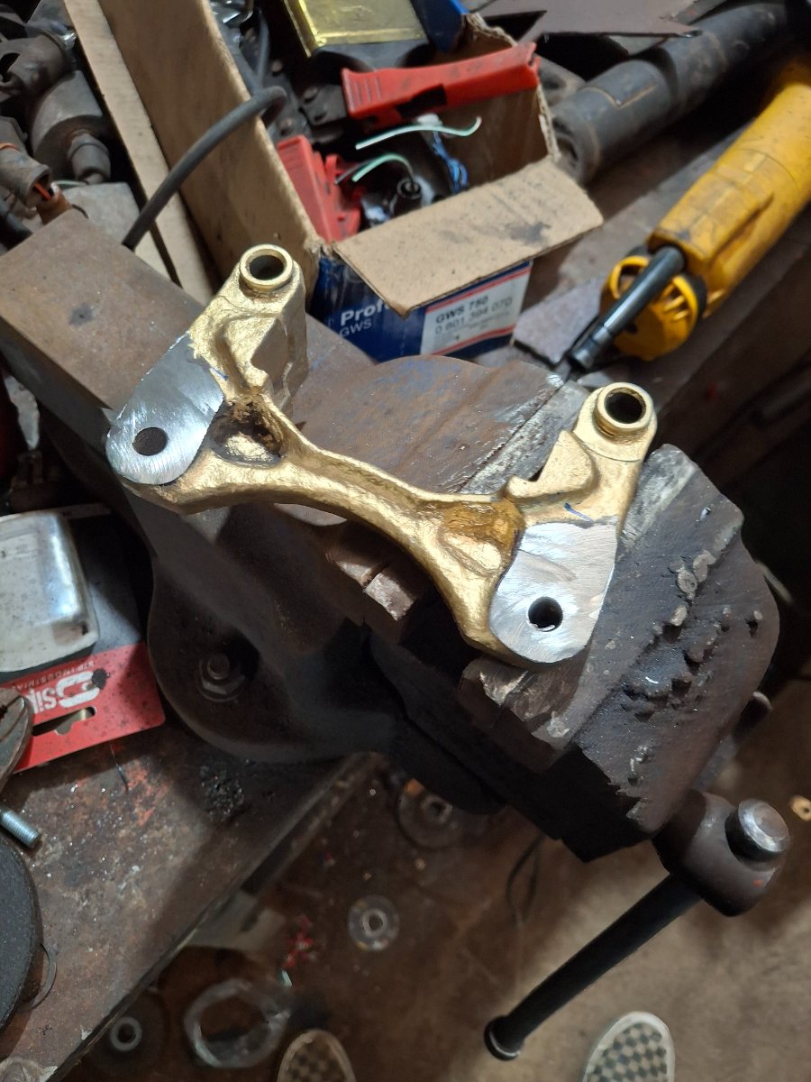

To get them close I had to weld up the old holes in mount and bring then closer in to axle for a better position on the disc. Also had to machine (grinder job) the carriers down to fit between the disc and the mount.
Only done one side so far. Will still need to modify the handbrake cable mount to suit. Also still waiting on my wheel studs, and I'm going to need to order some new banjo and slider bolts.

Well I had to make some changes
drilled holes to far in then damaged a carrier trying to make it fit. So had to reweld the holes and order some new carriers.
But both retaining plates/carrier mounts are now painted and fitted. And I'm going to take the new carriers to a machine shop to get 4mm taken off of them.

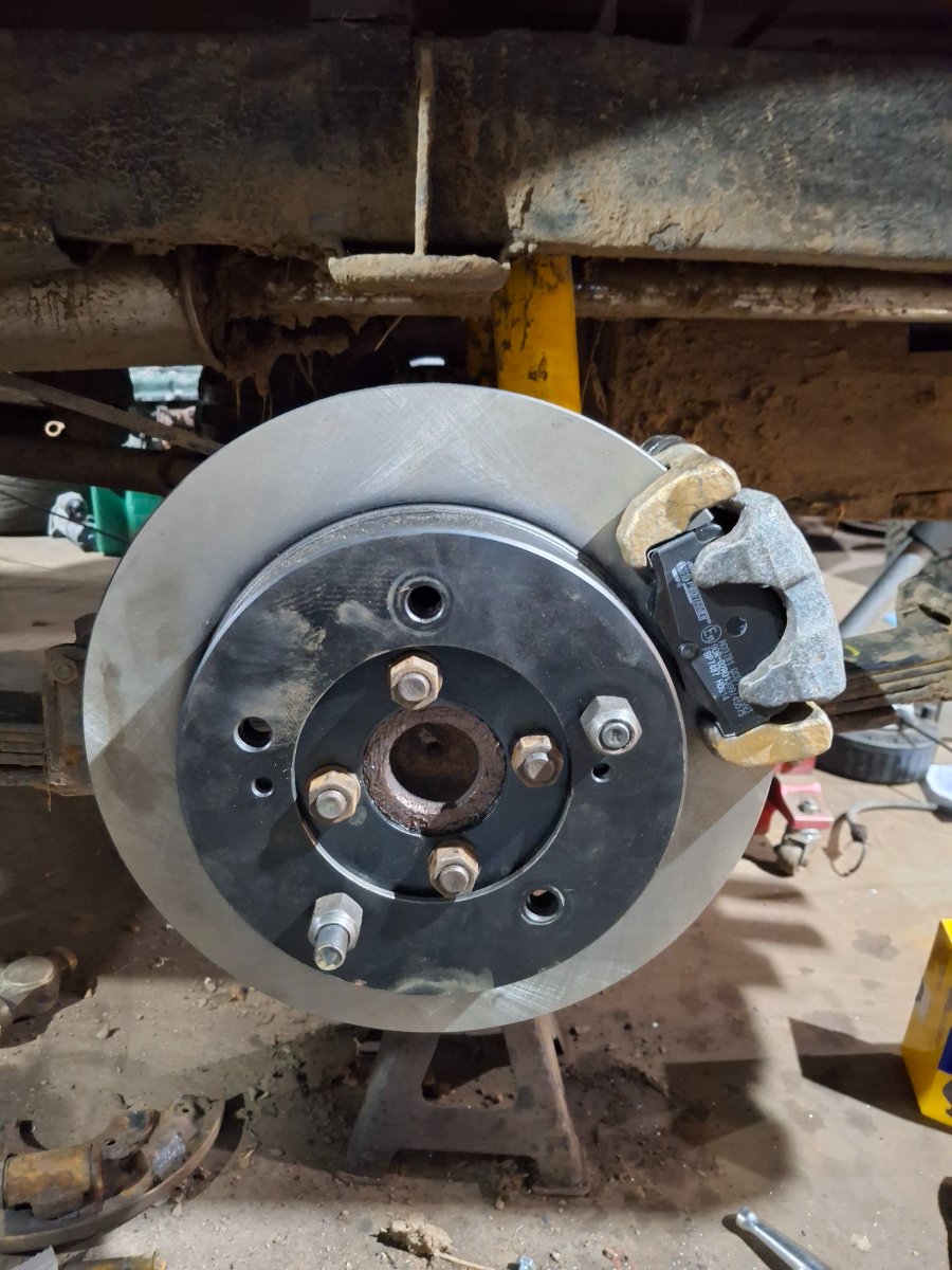

Re: Lwb Santana 1.3 Hif44
Dropped the carriers off yesterday got them back today, primed and painted them tonight after got the little one down. Hopefully get the all fitted up at lunch tomorrow.
Then it's the axle flexi to change and bias to fit
