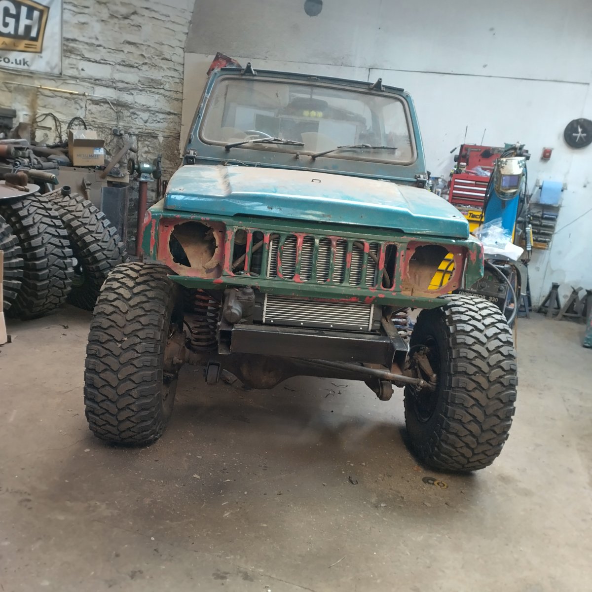

Braved the cold today and got a few more hours in.
Welded some tabs onto the chassis and made the bottom radiator bracket, I folded some 3mm steel and fit some oe land rover rubber mounts for the 200tdi radiator.

It'll be driving in no time. Like the rad size my mate did a xud swap and struggled for right rad. Think he ended with something wider. But that looks perfect for the job

Post by d_r_1989 » Fri Feb 10, 2023 11:08 am
Radiator and fan now mounted finally, made a little bracket that holds the top of the rad straight and the slimline fan.
Started to cut the front arches out to give clearance for the extra wheelbase on bump.
Just waiting on James to finish the rear cage so I can carry on, it's ready to run and drive when I put some fuel in.
The door was on just to check everything lines up, which it does

I'm holding off, as soon as James finishes the rear I can paint it then bolt the fuel tank in for final time. It's hard resisting though!
