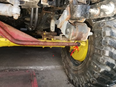

Need a couple of Track rod ends for this steering bar, SJ410.
Anyone know part number or can I get Universal ones to fit ??

Unfortunately that one isn't replacable, you need to purchase a complete tie rod

You can also get complete set ups from india as the Maruti Gypsy (not Gypsy king) has the same width axles as the 410. Prob best to email to make sure they send you the correct one before ordering because for some reason it also say samurai in the add.

Won’t be much use on that Z bar though. Original replacements are a straight bar for SPUA.

Thanks I thought they just screwed in at each end here http://www.euro4x4parts.com/suzuki_part ... ie_rod_end same as Landrover, thanks for links.ScottieJ wrote: ↑Thu Jan 28, 2021 6:30 pmUnfortunately that one isn't replacable, you need to purchase a complete tie rod

It's only the drag link that is a Z bar, a new tie rod can be used with his Z bar.
Only one rod can be changed on the tie, unfortunately its the opposite end to the one you need. You will need to run the Z bar with spoa (or you can convert to a much better high steer set up)border wrote: ↑Thu Jan 28, 2021 7:50 pm
The first link i gave you is just the long half of the tie rod so if you bought that you would need to swap your o/s tie rod onto it (or buy a new one to go with it) if you bought the one in the 2nd link you wouldn't be able to use the drag link as you'd have to run your Z bar but you'd have a normal drag link spare if you ever did swap back to spua like you have previously mentioned.
Also I just remembered you have samurai axles so you would need the longer samurai set up, not the 410 ones

Thanks Mate, It gets more complicated with the way my truck is built, if I ever get another I will make sure its all Origional instead of a mixture like this one.ScottieJ wrote: ↑Thu Jan 28, 2021 11:19 pmIt's only the drag link that is a Z bar, a new tie rod can be used with his Z bar.

Also I just remembered you have samurai axles so you would need the longer samurai set up, not the 410 onesThese are samurai width ones, there are cheaper ones on ebay https://www.ebay.co.uk/itm/SUZUKI-SJ413 ... Swa0VZ6z8x

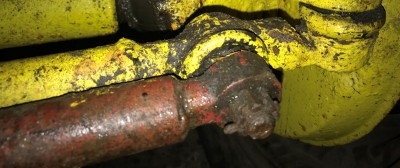

Really Sorry. Think I made a mistake here. Its not the Track Rods on both ends of Bar, its the Ball Joints on each end of Z bar .
Can these be replaced ? Thanks

The ball joint in the first picture is part of the tie rod. Looks like the rod end at the other end of the Z bar can't be replaced either so you are going to need a new Z bar making and a new tie rod unfortunately.
Yeah unfortunately modified Sjs can be a nightmare, especially with the lack of decent aftermarket parts suppliers in the UK, its the reason i build everything myself.

Time to convert to half high steer i think
