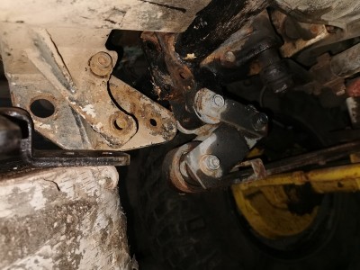

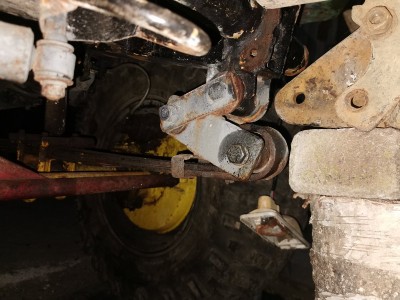

Just a Quick Question. Are these Shackles Normal ? Or should / Can they be adjusted ?? Thanks
Posts: 7539
Re: Shackles
Post by Jordi » Fri Nov 06, 2020 6:20 pm
They are an aftermarket shackle.
Designed to give more flex.
General opinion of most of us is they cause additional axle wobble on the road, if over stretched can fold back the wrong way or jam (yes it happens, i have a similar setup but bolted in a fixed position).
When they droop down you don’t really gain any additional traction as the wheel just hangs, no weight pushing it down.
Remove, swap for standard shackles.
border
Posts: 184
Re: Shackles
Post by border » Fri Nov 06, 2020 7:20 pm
Thanks Mate, will see how it drives on the road first then take it from there, just thought they looked a bit odd.
