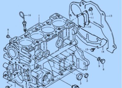

It is a bit more than a gasket, as the attached image shows, (not your engine)
You will need it as the starter motor bolts through it etc.
