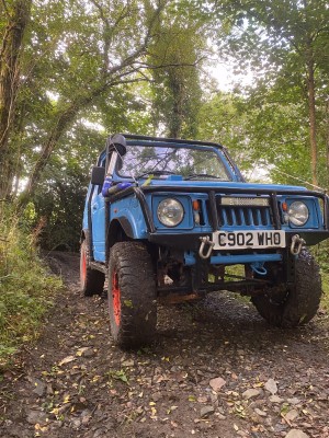

A bit has changed since I was last on I have gone ahead and got my self some brand new wheels abs tyres 235/75/15 also finished my roll cage :weld:
Yes Scottie I have bump stops fitted the wheels still Catch in places off road so I will have to get the hammer out at some point
Also looking at a set of 3” rear leaf springs and a decent set of shocks if anyone knows the best place to get them ? I’m running calimini springs atm and pro comp shocks which are leaking thanks

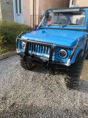

Post by dazerede » Wed Feb 09, 2022 6:13 pm

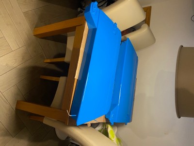

Got new winch rope and also managed to make a set of half doors for the Sj with all the spares I have shame there slightly different colour
