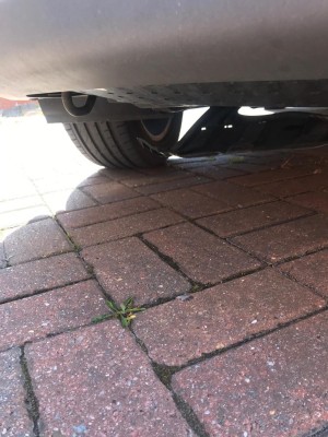

My wife found this hanging down this morning on her car 2015 Vitara. Is it the headshield?

That looks like plastic rather than heat shield, probably just some under tray. Have a look where it mounts, might just need clipping back up or missing a screw.
Better do it sooner rather than have it catch and rip off on something.

As Tim said its an under tray, either attach it back or if clips or screws are missing remove it till you have new ones

Thanks both. It was the front platic that I've clipped back into place. Does looks like its missing screws but it has gone back in for now.
