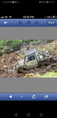

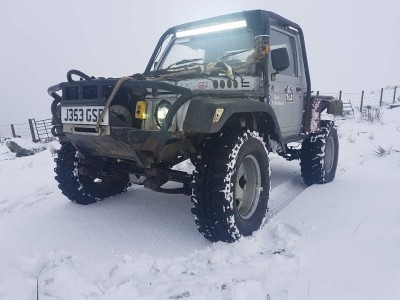

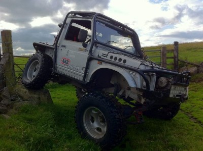

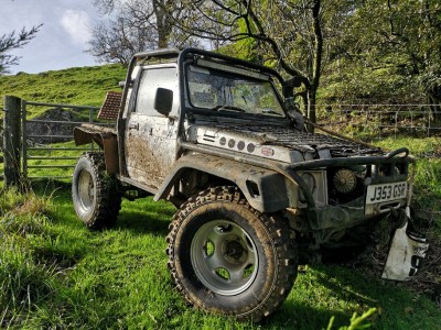

Hello used to be member years ago and figures I'd join back up to show my toy and ask some advice
Here my 92 Samurai, spec is
1.6 16v Vitara engine with complete Vitara loom, clocks and fuel tank, Range Rover 150a alternator
Original gearbox
D and G tuning super low rock lobster
Standard axle internal with rear lockrite
Rear disk conversion
3" lift springs (under axles), D-Flex shackles, angled Astra Shocks
X-eng Transfer box disk brake
7.5 GV rims cuts and rewelded for super off set
265/75r16 Special tracks
Full external cage with traybacked rear end.
Front and rear winch's
2x batteries, led lights front and rear
Looking to upgrade the axle internals and in considering trial tough long feild HD shafts
Has anyone got any experience of these as they seem pretty good value compared to swapping axles for Toyota ones etc.
Cheers Andrew
