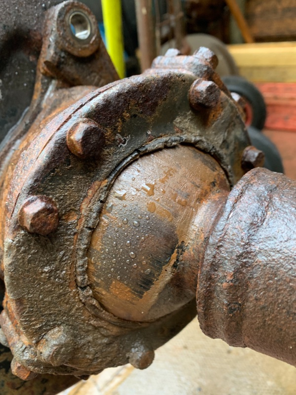

Did a bit today

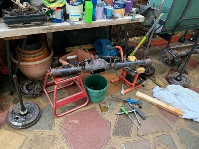

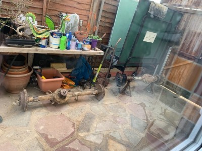

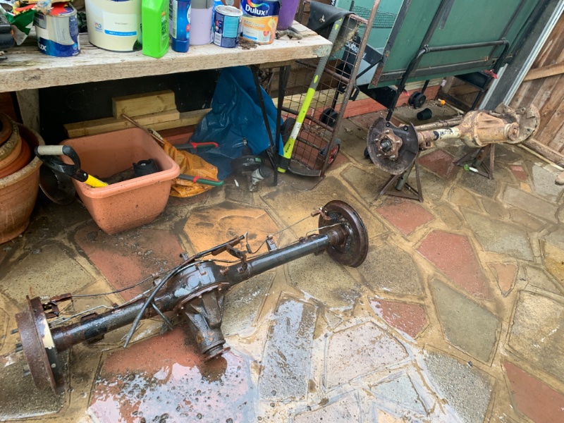

Cleaned axles degreased best I could the started on the rear axle
Stripped it right out to do the perches and rear disc conversion

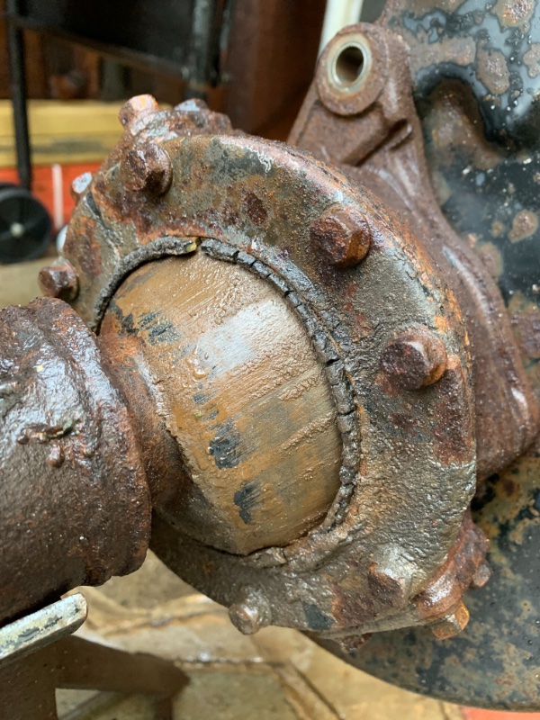

Front look like they need swivel seals
Hopefully should have perches made up this week then we shall be well on the way

I’m slowly going though the axles
Rear diff looks like it needs the pinion seal doing looks like it’s got back on old oil around it so I’m thinking suspect seal ???
Front axles need the swivel seals doing so il have to order them at some point
Should have perches made up soon
Il get them on then it’s time to tart the axles up and rebuild

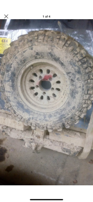

Other than that noting is happening other than I scored a set of 31’s cheap but need to get 2 tyres
