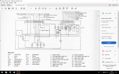

I believe the fault is the alternator. Looking at this diagram the 3 lights in question will light when the alternator is supplying ground. I assume the handbrake warning and fluid level warning light up with ignition on but engine not running as a test function (The are 2 diodes shown which appear to do this). With the engine running the brake warning circuits should operate as normal as the ground should be taken away (or more likely become positive). My money is on the alternator is fecked, but hell what do I know :S .

Thanks for the wiring diagram, I'll have a look and see if I can make sense also.

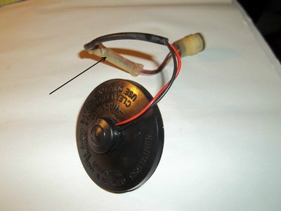

Check your brake fluid level there’s a diode somewhere in then wiring (i have been trying to work out where it actually is for years but it seems to be hiding in the loom somewhere) and when it fails and the brake fluid level is low then it causes your battery light to come on.
Its hiding in here..

That’s not the same as my brake master cylinder cap..... it’s been swapped to a vitara master cylinder, same cap as on later SJs/samurais.
Maybe that’s why I can’t find it :hahaha:
I’ll have a look on my Lwb samurai, see where it is on there, that has the same cap as my Vit MC
