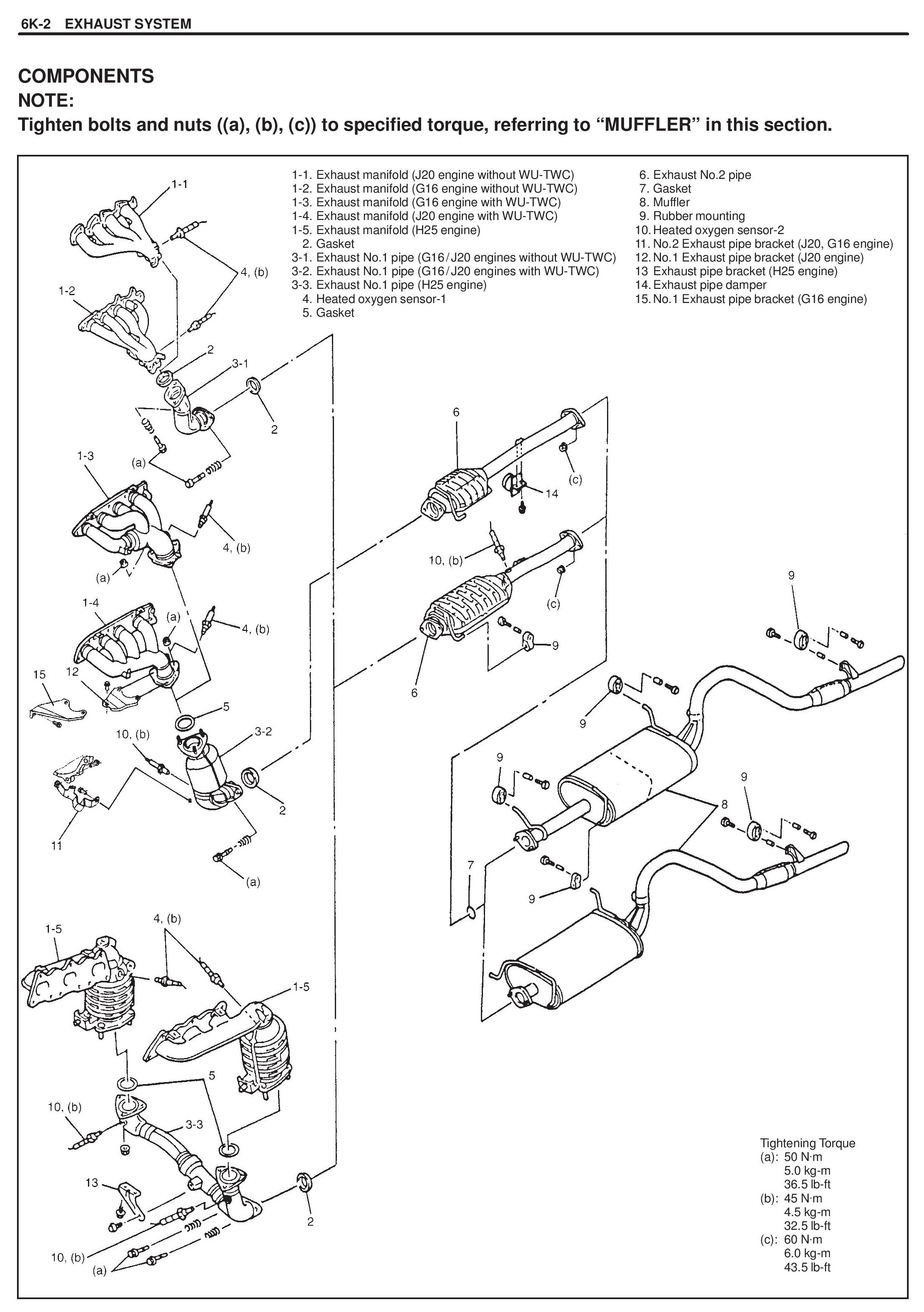

Hi guys, I have a 54 plate 2.0 5 door GV, and I would like to ask if anyone knows if my vit is fitted with two cats in the exhaust system. I have a serious rotten flange joint in between what looks like two cats. I have printed off a exhaust components page and it asks the question, J20 engine with WU-TWC or without WU-TWC. Any help would be much appreciated. Thanks.

Hi Rob, not 100% sure on the GV, but usually they have 1 cat and then the other boxes are silencers.

WU-TWC = Warm-Up Three Way Catalytic Converter
Re: exhaust question
Post by Darrell » Sat Jun 11, 2016 3:10 pm
This should help identify what you have..

Darrell wrote: "Hell" What do I know!
....a lot? That was the diagram I was searching for :D

Thanks for your help guys, I have the diagram showing the components, but how can I identify if I have or have not the warm up three way cat converter, and am I correct in assuming that my vehicle has one cat fitted? Thanks guys.

I guess you'd like to know this weekend? but a quick phone call Monday to the parts guy at your local Suzuki dealer, will tell you with just your reg no.
