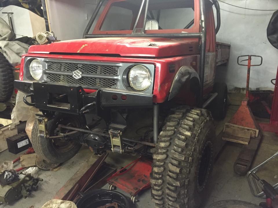

Post by mike harris » Fri Oct 16, 2015 7:18 am
From treps to boggers?
Treps are more designed for racing, they clog up and have to be spun to a high rpm to clean. That's just breaks stuff !!
These boggers are rare as they are so narrow, I could never afford to buy a set from America, so I swapped my used treps for this basicly new set of 38.5/11/16 boggers :)
Going to be black this time Andy !

I know the reason why people run them but I just can't get my head/eyes round tall tyres that aren't wider too.

Looking very nice so far mike! i like the new tires

Post by mike harris » Sat Oct 17, 2015 10:00 am
Treps work very well, at speed on gravel and on rocks. The whole ultra 4 style thing suites them down to the ground.
Hence why they are not so wide.
These boggers I have hve very deep tread, there pretty much new. There 38.5/11/16
I've mounted them on my wheels but might do away with the headlock as the sidewalls bulging.
These actual tyres won the Croatia trophy, says enough to me !

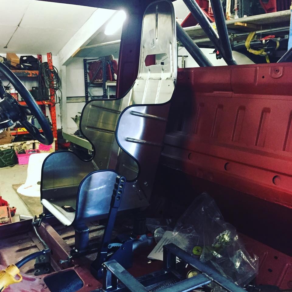

Post by mike harris » Sun Nov 08, 2015 8:27 am
Seats mounted, had to get them in to work out there harness bar, hydraulic handbrake is going to be quite useful :)
