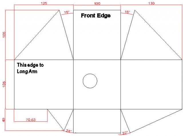

Transferbox guard template
Posts: 11621
Post by ScottieJ » Tue Mar 04, 2014 4:15 pm

Ok ideal what's the best thickness metal to use

I used 5mm on mine

Would have thought 4mm would be sufficient. Look as the strength of the mounts. If you hit a real immovable object its going to rip it off the mounts before damaging the guard.
