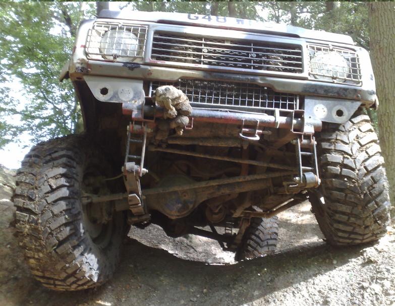

they shod soften ova time i cheted a bit an parked mine on axel stands over night
an they lossend right up. i did use 2 stands but i only have a pic with one under
use them to get cross axel ie one under the frunt driver an rear pasanger.

Urbanzook have you extended the bumpstops on yours because it looks like your over flexing your springs, they shouldn't be able to flex to the point that they reverse, just to the point where they are flat. It will kill your springs super fast if you leave it, obviously you won't get as much flex but whats worse? a loss of flex or springs that flatten out real quick?
as i dont no exactly wot you mean by bumpstops no i ant,
you now have me worried as i built my anus my self from new parts an 3 doner cars,
an is cost me more than enough so far last thing i want is to need new springs again,
although it wood be coils this time round.

bump stops are just bits that go on the axle and the chassis, if you look behind your front wheel there will be abit of metal coming from the chassis, all brased up, (if i had a pik i would post) and usualy on the axle there is like a pointy bit of rubber which is the bumpstop its self, they just stop your springs from bending the wrong way. you could get some landrover bumpstops from ebay and attatch them to the chassis part, or if they are abit short get some box section, attatch the landrover bumpstops to that then weld that to the chassis part, shouldnt cost to much, but would definatly be cheaper than sourcing new springs.

ow them bits yer there there no worrys
