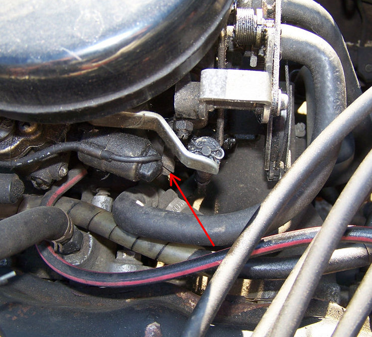

Right then , that's sorted the idle speed surging when I draw power , but now it wont idle at all , is there a way of setting the idle speed on tick over like the old carbs ???

Yes there is an idle adjustment screw, Darrell's prob got a pic but it's a long screw that pokes diagonally up you can see if looking down at the carb between the rocker cover and carb plenum.

thanks for the info scottie , I was panicking about trying to find a new carb

It's been a long time since I've adjusted mine, think it's this one.. :er:

Thank you Darrell and scottie , ive disconnected the idle plug and adjusted the idle screw , shes now running sweet as a nut , I shall give her a good blow tomorrow and see if shes ok , ive only just had it and its been standing for 12 mnths , 62 k genuine miles , I gather quite a find , just wanted something for shooting and stumbled across it , its completley original .
